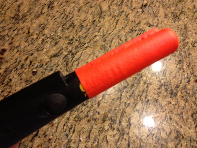

I had only used my Pro Pointer a few times and was already seeing some scrapes on my new $120.00 magic wand. I have also seen people talking about how they have worn out more than one pointer due to this very thing and I wanted to prevent that from happening. I was also concerned about leaving my pointer somewhere or accidentally dropping it and not being able to find it so when I heard people talking about plasti dipping it, that seemed to solve a lot of problems. I was concerned about it looking like a pinterest project gone wrong or the plasti dip not coming off easily but I gave it a go and I am quite pleased how it came out. Actually surprised.. it came out much better than I thought. I just masked it off sprayed 5 coats (30 min dry time in between) then dressed it up with a razor blade after I finished. Couldn't be any easier. I would recommend it to anyone. This will definitely protect it from abrasion and lengthen the life of the pointer also the plast dip peels of cleanly when you need it to and if you don't like blaze orange it comes in just about any color. Hope this helps anyone thinking about doing it and is apprehensive like I was.

Wow that did come out nice :shocked04: Let us know how long it last you before you break trough the layers.

You can find it at any hardware store in the paint section. There are 2 types. One is a can that you can dip items into and the other is spray. I used the spray type and both types come in numerous colors. The cost runs from 6-9 dollars. It seems cost is more based on color and certain colors seem to run a few dollars more.
Does it affect the depth of the pinpointer? Or any other side affects?

None that I notice. I did air tests before and after and no perceptable change. The great thing is, if you don't like it.. it peels off cleanly. I have used it several times now and after a wash it still looks brand new so the material is durable. The spray on type whichis what I used does cry more porous than the dip type, which makes it a little harder to clean but it doesnt bother me. If I ever need to redo it, I will use the dip type for that reason only.
