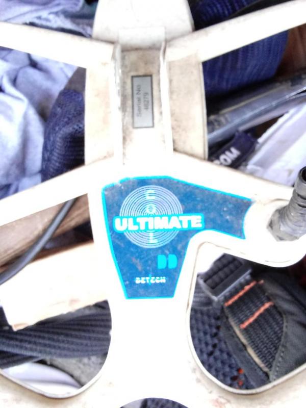

    Is this coil compatiable with the V3i?

    Roger , it looks like an "older" version of it so it might work ok or you might not be able to function the "boost" on your machine . the up to date "butterfly" coils are black in color and have been for some time . Is that the 10x12 ?

    Thanks Dan. I'll have to take a look to see what size it is. I did reach out to DTech to see what they had to say but haven't heard back. I did post over at the Whites Forum as well. They had a complete server failure & had to rebuild the forum from the ground up. Fox says it should be ok.

    The lower two frequencies will work fine but the high frequency is skewed. I was able to use the older Detech coils in 3 frequency modes effectively for most coins and high conductive targets. The lower conductive targets gave off inacurate VDI responses. I was using these coils waiting for replacements of the factory D2 coils that I continually had issues with. lol
