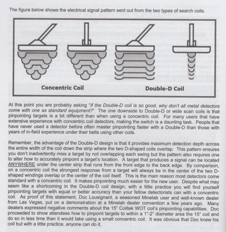

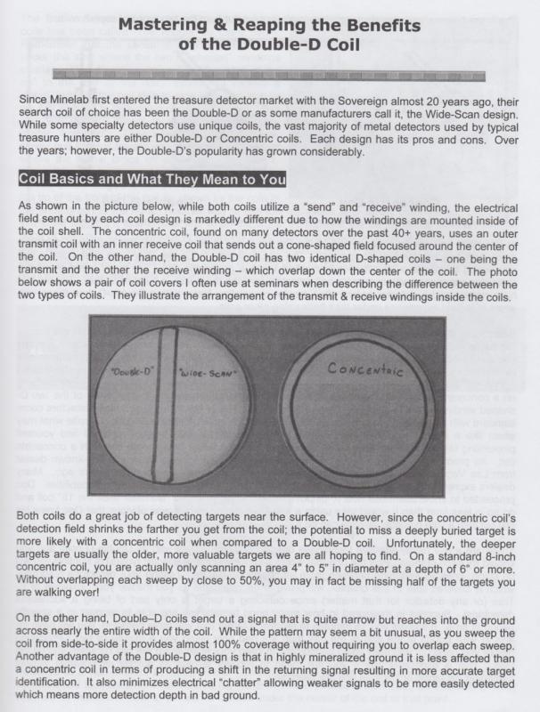

    Some insight on the subject from Andy Sabisch's E-Trac book:
Size:  97.0 KBName:  DOUBLE-D 1.jpg

    Yeah, all the things you mentioned are the reason we have all moved to DD but I was thinking one possible advantage with concentrics is that your swing doesn't have to be perfect. You can make bigger passes without changing your body orientation. But it's just a small advantage over-all....and like you said, the deep part is very small.
    Interesting, he doesn't bring up my point at all.
