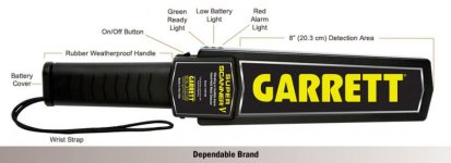

I wonder if something like this would work? Super Scanner® V Hand-Held Metal Detector, PN 1165190, MSRP: $199.95 (U.S.). Originally designed for use at the Olympic Games in 1984, Garrett's Super Scanner is the most recognized hand-held metal detector in the world.
Yes, it would be perfectly ergonomic in use, and for a good price. Unfortunately, it is not sensitive enough. I have read research on it, and asked for some tests. It is a great security machine, but a bit too shallow for my needs.
