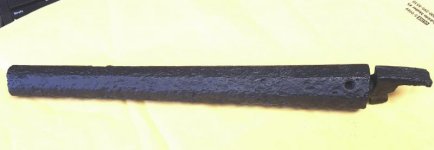

mine is the XY screen , a lot of iron (especially the deep chunky ones) can sound great but the most often splay or fragment on the xy screen but i'm biased because i like digging deep big iron 9-19 iron shoe buckle , cleaned.jpgJan4th cannon ball before after.jpgbarber half and lockplate.jpgaxe1005111_zps66284091.jpgjan. 1st shoe bukle and file .jpgdec. key.jpgFlintlock paited.jpg

Might I suggest iron targets that seem out of the ordinary looking on the XY screen , with the exception of the lock plate which looked and sounded similar to an ox shoe . the cannon ball was a very deep and "round looking " iron target without much line fracturing or splaying with much of the action in the lower left quadrant of the XY screen , some two tine forks can give off a similar line appearance as can some iron shoe buckles .
