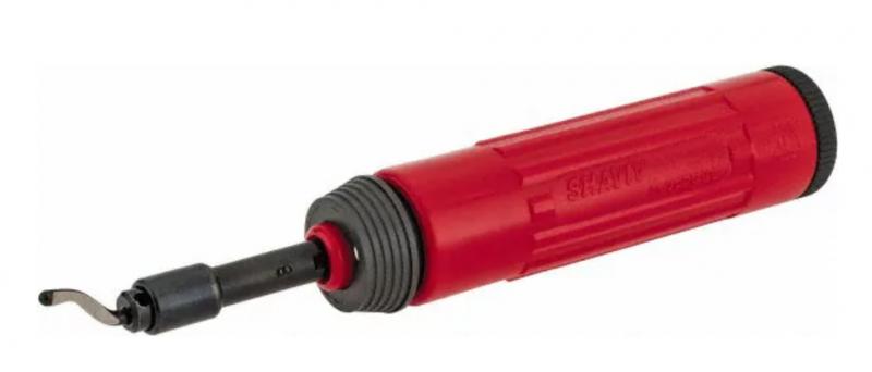

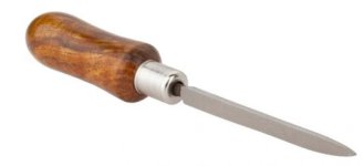

Those look great! You can also shave and deburr the edges to get a cleaner look, or to even add a chamfer. The deburring tool has options for a variety of knife edges for various shapes. Another trick is to use a torch to just slightly melt the cut edges to remove the frosted/opaque plastic and make it clear again. Make sure to practice (a lot) on some scrap pieces before trying it on final presentation pieces. It's really easy to chew up edges if overdoing it with the deburring tool, and the triangle knife takes some practice. Torch work does a beautiful job, but can be touchy. Too much can cause the edges to burn and it happens very quickly. But if done right, the results are night and day.
