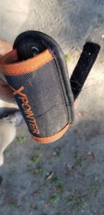

So, after half a season, I'm sorry to say I'd never buy another Xpointer from quest. It only lasted months before giving me fits. Now, even the holster broke. My old Garretts lasted two or three seasons and the holsters NERVER broke.
I guess I could get them to replace it but I don't really like it when it IS working.
After turning it on, it gives a short ring just as you touch the dirt...you always think it's the target...I can't get used to that.
Then the vibrate/sound/sens button is too close to the on/off...I'm always accidentally changing the settings.
I've learned I do not need to change the sensitivity on my pointer. Just give me an inch and a half then I can plan where to dig next.
Sorry I was so excited when I first received it...and I'm sorry if mine is just a clunker...so why don't you just ignore this entire thread.:lol:
