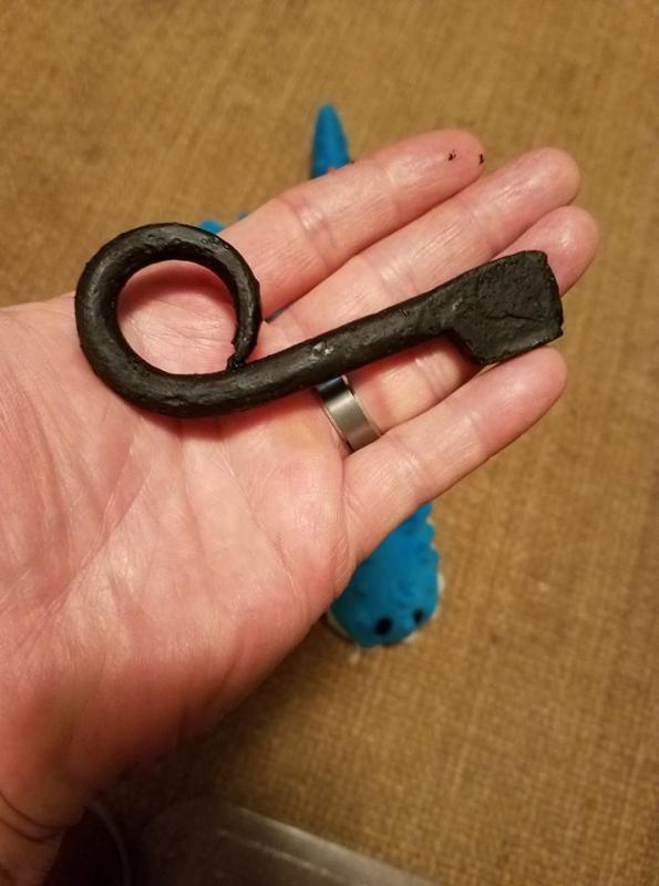

    I'm a complete novice and only recently learned how to use electrolysis through watching YouTube videos. My method, at this time, is to perform the electrolysis and let the piece dry for about 30 minutes. That may not be enough drying time. I then coat the pieces heavily with Rustoleum Rust Reformer to try to stop the pieces from rusting again. I really like the flat black coat on the pieces when done. Here are a few of my better pieces: Name:  19400022_10209377263132153_8282908845028142552_n.jpg

    Try the acetone rinse to remove the moisture Donnie. Some iron relics will start to rust as soon as you expose them to the air. After a quick drying with paper towels to remove excess water, I'll put the relic into one of those cheap quart size plastic mixing containers, pour in a couple of ounces of acetone, let is soak for 30 seconds. If it is too big to be submerged in the acetone, just slosh it around for a minute. Remove the relic. Any trace amounts of acetone on the relic will evaporate in a few seconds. Then preserve the relic with your preferred coating.
