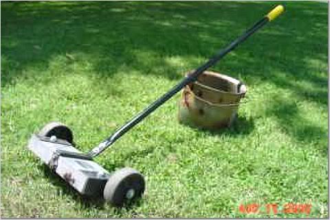

    What is a big help in cleaning a dump site is a large, strong magnet pulled through it all. Clears out a lot of undesired junk. Here's a couple I use - built the smaller one. Steve in so az

    What a great idea Steve. I bet just the surface stuff hides a lot of desirables. Tomorrow I'm going to try another square foot, after I take Coinnut's advice to first dig the differing signals in my search area.
