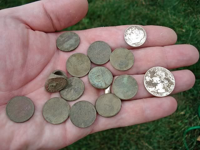

Re: White's Spectra V3 Vision
That really does look like a great location Leon. Thanks for taking the time to share the results with us here on the forum. One of these days I hope to get a chance to hunt a cellar hole.
