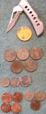

Tested out the BigDawg coil today at the local high school.I set it to only hit on 83 and up. I figured it should hit quarters pretty deep. I had the RX at 5 the Disc at 80 and the AM at 55 in coin and jewelry. Using the 2.5 freq. It gave alot of false signals and overloaded often. Turning the RX down to 4 got rid of most of the falsing. I have to say that i did hit this school before with my DFX and my Bigfoot coil (before it quit working) so i already got quite a few quarters outta there.
The bigDawg found 5 quarters, none were deeper than a couple inches. The sound of the signal wasn't very crisp either. I will try somewhere else with the DFX and see how well it works on that.
Here's a pic of my findings. The four shiney pennies were found on the ground where i parked. The knife, one dime the nickel and one penny were eyeball surface finds.

After testing this coil out on my DFX and comparing it to the Bigfoot coil with the exact same program. I would have to say save your money! The older Bigfoot beat this coil hands down. The signal was crisp and loud over quarters that were up to 4 1/2-5' deep. While the Bigdawg wasn't hitting the deeper ones and alot of the shallow ones gave off crackling sounds. I wouldn't think it would work any better on the V3,V3i. That's my opinion.
