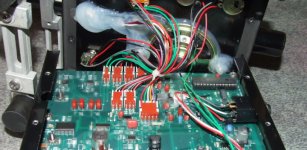

ahh... another thing to tink about is, please do NOT raise the coil over control box level after submerged because the water inside the lower shaft (tube) will rinse the electronics.
Normally the gap between electronic box and pod, where the wiring goes through, is sealed with some type of silicone. But better be careful than frying the MXT.
